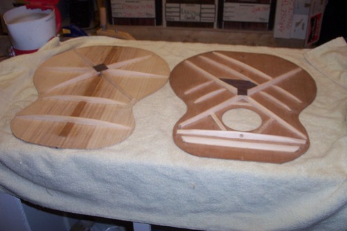

All right folks, here is the latest from the shop

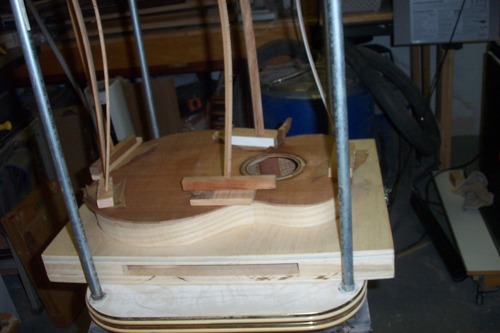

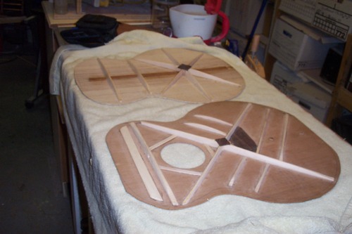

Finished fine tuning the top and the back braces

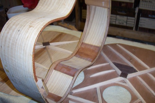

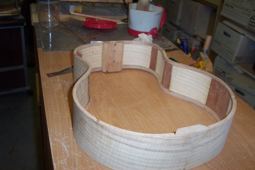

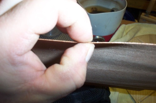

Glued some vey thin veneers inside the rim
these veneers are almost paper thin and can be cut with cisors

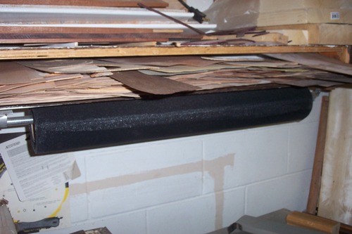

I bought a full box of the stuff at Lee Valley last year that should last me a long time, it's got plenty of exotic veneers like wenge, jatoba, leopardwood, and pretty much the same thicknesses, i thought i'd start using this stuff for side reinforcements to prevent cracks. Got a full shelf of veneers here

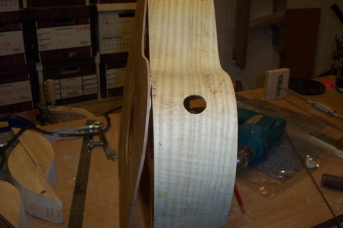

The nice thing about it is that you can make contrasts even inside the soundbox especially when you have a soundport to look through like here! I think Uncle Norm will like this!

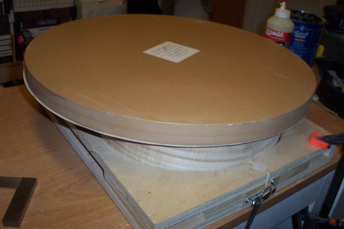

Sanding of the rim, gotta build me one of those jigs that makes that step easier on the arms, next time i guess!

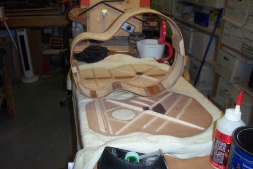

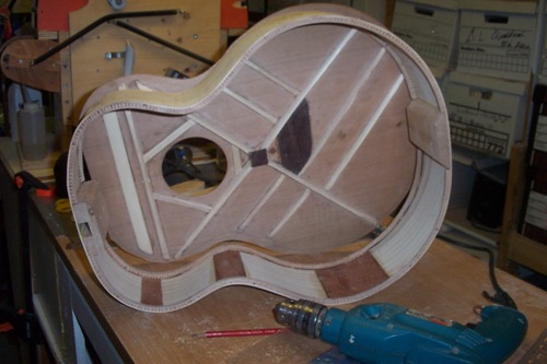

Finally, preparing the notches in the kerfed linings to accept the X-BRACE and the UTB, not an easy step but i'm getting better at it! i just draw 2 lines on each side of the braces on the side itself that i report onto the kerfed linings and then connect together with a long ruler if that makes any sense.

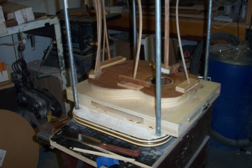

now the time to glue the top plate, i finally gathered enough courage to try HHG with a lot of dry runs in my head and a timer right next to me and it was pretty scary at first but i managed to keep calm and it it ended up fine, i will repeat the experience for the back of course and also the bridge this time.
this guitar is special to me, not only because it's a gift for my uncle but because i'm experimenting a lot on it(parabolas, soundport, veneers as side braces) and the fact that most of my jigs are built makes it sooo quick that i constantly have to remind myself of going slow and it's hard!

Looking great Serge, your bracing looks good, can't wait to hear the reports upon completion!

Thanks Greg, i forgot to tell you that i will try your type of bracing in the future, i'm really interested by that X bracing of yours on the back, it will be interesting to compare the two!

Looking very fine, Serge. That bracing looks very good now, it's gonna sound great.

Looking great Mate ! Bracing looks a whole lot better.

Hey Serge, take a look at this cool sanding jig from Mike Doolin's shop. I'm just finishing mine up and I think it'll work great. I always wanted to make one like Mario, Tim and many other's have built but having only 185 sft of shop space, there just isn't room.
Doolin disk sander

Hey thanks Rod, that is really cool bro, i will save that to file for sure, learned that my arms are not what they used to be! We must have been posting at the same time bro! Now i'll have to scrounge another washing machine motor for sure!

I was really happy with the double "X" braced back, it just sounds good.....not sure that will translate into a better sounding guitar, but I will let you know when I string-er-up. I'm sure the vibrancy of the box is partly due to a better braced top as well, but I believe this back is a contributor as well.

Those braces look a lot better, than the first pic's you
posted. Great coaching by Colin.

Looking good Serge, I like many things about this build, the bsck bracing for sure, but I really like the idea of using veneer for side bracing and contrasting wood color - very cool, will borrow that one for a future build.
